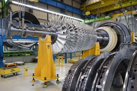

A GE Vernova gas turbine. Courtesy: GE Vernova
“They are a tremendous anchor of power generation for the industry,” Benoit added. “It is very important to keep these units operating.”
Gas turbines can be utilized to install capacity quickly and retrofitted/modernized to keep them in operation long after their intended lives, but procuring them isn’t always an expeditious process.

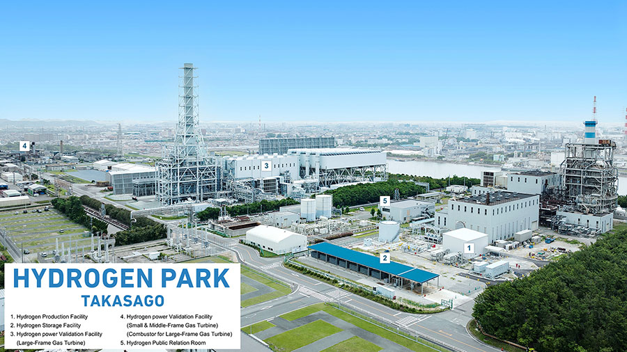

Takasago Hydrogen Park
Mitsubishi Power’s hydrogen R&D playground, the Takasago Hydrogen Park. Courtesy: Mitsubishi Power
Mitsubishi Power has an in-house validation site for full-circle hydrogen production, the Takasago Hydrogen Park, where the company is already running GTs on a 50% hydrogen mix. Since large quantities of hydrogen are expensive, especially in Japan, Mitsubishi Power decided to make their own with an on-site electrolyzer. It’s stored in bottles and two salt caverns.
“We started at 30% (hydrogen fuel mix) right off the bat, which is a lot,” shared Ben Thomas, the company’s director of hydrogen production.
